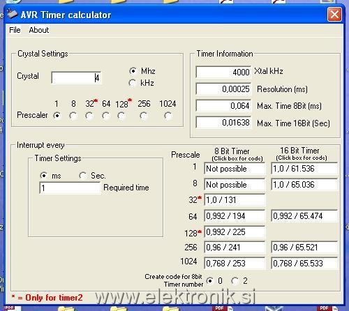

Koda:
const Timer0Reload = 15
config timer0=timer,prescale = 256
load timer0 , Timer0Reload
on ovf0 Timer0_isr
enable ovf0
start timer0
enable interrupts
'Add your code here
Timer0_ISR:
   load timer0, Timer0Reload
   'Add your ISR code here
  return
'Timer value explination
' The timer is a 8Bit timer, it overflows when the timer reaches 256
' The AVR is running at 4000000Hz, the prescaler is 256
' Each tick is 0,064 ms  -  (1 / CPUSpeed in KHz ) * Prescaler
' The timer needs  15 ticks to reach the required time  ( 15 * 0,064 = 0,96ms)
' The start value for the timer must be set to 241 so that it will overflow at 256 after 15 ticks
' NOTE: The load command does the inversion for you (256-value or 65536-value)
 Velikost datoteke:  43.48 KB
