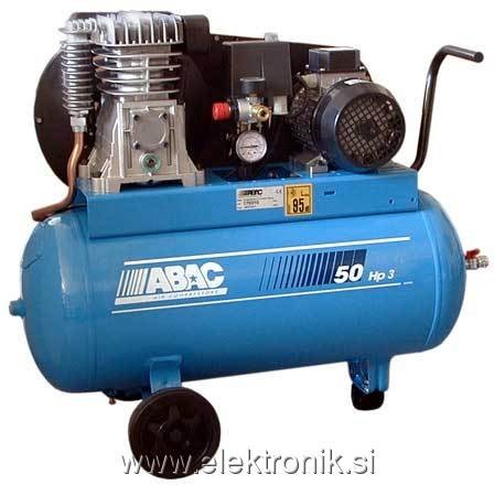

PRILAGAM SLIKO MANJŠEGA KOMPREOSRJA. UPAM, DA BOŠ LAHKO VIDEL VSE KARJE POTREBNO.
MANOMETRA NA KOMPREOSRJU STA DVA SPODNJI KAŽE PRITISK V POSODI ZGORNJI PA V CEVI. S TISTIM RDEČIM GUMBOM PA NASTAVLJAŠ PRITISK V CEVI NEODVISNO OD PRITISKA V KOMPRESORJU. TAK REGULATOR LAHKO SEVEDA PRITISK LE ZNIŽA ZVIŠAT GA NE MORE.
ČE TEGA RDEČEGA GUMBA (REGULATORJA-1/3 PRIPRAVNE GRUPE) NIMAŠ POTEM JE DODAJANJE ŠE ENEGA MANOMETRA BREZPREDMETNO, KER BO KAZAL ENAKO. ČE PA HOČEŠ IMETI REGULACIJO TLAKA V CEVI PA MORAŠ DODATI REGULATOR, KI IMA ŽE VGRAJEN MANOMETER, MISLIM DA SE ŠE VALJAJO V NEKATERIH HOFERJIH.
VARNOSTNE VENTILE SE DA NASTAVLJATI NA DRAŽJIH KOMPRESORJIH. ČE IMA KOMPRESOR NEKO PODJETJE SO PONAVADI TI VENTILI PLOMBIRANI, POLEG TEGA JIH JE VEČ, PONAVADI NA VSAKI GLAVI IN ŠE NA POSODI. IZVAJA SE TUDI REDNE TLAČNE PREIZKUSE.
ČE TI KOMPRESOR VKLOPI ŠELE PRI 2 BARIH IZKLOPI PA PRI 6 JE VERJETNO RES NEKAJ NAROBE. IDEALNO BI BILO NEKJE VKLOP 6 IZKLOP 8. ČE LAHKO LEPO PROSIM POSLIKAJ TISTO TLAČNO STIKALO OD ZNOTRAJ.

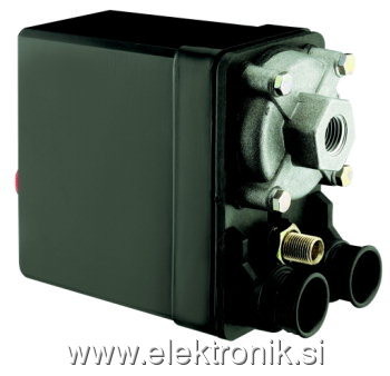

KOT SEM REKEL. UPAM, DA BO V REDU IN BOŠ LAHKO KAJ VIDEL. .

SUPER SLIKA. KAKOR VIDIM IMAŠ MANOMETER NA IZHODU REGULATORJA TLAKA, KAR POMENI, DA TI LE TA KAŽE PRITISK NA IZHODU. ČE DODAŠ ŠE EN MANOMETER PRED KLASIČNO HITRO SPOJKO, KI JO IMAŠ NA TLAČNEM STIKALU, TI BO LE TA KAZAL DEJANSKI TLAK V POSODI. ČE DO KONCA NAŠPONAŠ REGULATOR, BO VERJETNO KAZAL TUDI TISTI NA REGULATORJU TLAKA ENAKO. NI PA NUJNO, KER IMAJO REGULATORJI TLAKA NAVZGOR NEKO OMEJITEV, KI JE LAHKO MANJŠA OD MAKISMALNEGA TLAKA V POSODI.
PAMETNO JE, DA KOT SEM NAPISAL DODAŠ ŠE EN MANOMETER DIREKTNO NA IZHOD TLAČNEGA STIKALA IN TI BO LE TA KAZAL DEJANSKI TLAK V POSODI. POTEM PA POIZKUSI PONOVNO NASTAVITI STIKALO.
ME PA ZANIMA ŠE NEKAJ. IMA TVOJE TLAČNO STIKALO SPODAJ LE EN PRIKLOP? NAMREČ PONAVADI GRE NA TLAČNO STIKALO EN IZVOD DIREKTNO S POSODE, KOT JE VIDETI TUDI PRI TEBI. POTEM PA PRIDE ŠE MANJŠA VISOKOTLAČNA CEVKA IZ POSODE PREKO NEKEGA VENTILA ALI MEBRANCE (NE RAZUMEM ČISTO ČEMU SLUŽI IN KAKO TOČNO JE SESTAVLJENO, SAMO VEM, DA JE PONAVADI TAKO) NA MANJŠI PRIKLOP SPODAJ NA STIKALU. BREZ TEGA ZADEVA NE DELUJE PRAVILNO. PRILAGAM SLIKO TLAČNEGA STIKALA NA KATERI JE VIDETI TA PRIKLOP. NA NEKATERIH SKLOPKAH JE TAM KAR PUŠA S PRSTANOM ZA PLASTIČNO VISOKOTLAČNO CEVKO.

JE JA. NA SREDINI STIKALA SPODAJ JE MANJŠI PRIKLJUČEK, KI IMA NOTRI V MATICI TULČEK, KI SE DA NA KONCU PRIKLJUČNE CEVI, DA JO POTEM MATICA STISNE. V MERKURJU SEM VIDEL TO TANKO CEV. TA CEV GRE K MOTORJU IN NA STIKALO. PRI ENEMU KOMPRESORJU JE PA BILO, DA JE ŠLA TA TANKA CEV V POSODO.
GARANCIJO NE MOREM UVELJALAT, ČE SEM GA ŽE ZAJ...
MOGOČE VEŠ, KAKO JE NOT SESTAVLJEN? IMA SPODAJ PLOŠČO IN ZGORAJ N KO SE TA VIJAK SUČE SE SPREMINJA SPODNJA IN ZGORNJA ALI NE?
MI ŠE NAPIŠEŠ, FIRMO, KI SE DOBI PRI NAS PA DA IMA DVA VIJAKA ZGORAJ. NA ŽALOST NIMAM KOGA, DA BI MI POGLEDAL, Z KAMERO PA NE PRIDEM ZRAVEN. EDINO ČE GA DOL VZAMEM IN RAZDREM. SAMO PA VPRAŠANJE, ČE BI GA SKUP DOBIL.
SE PRAVI,D A DAM MANOMETER NA PROSTO LUKNJO, KJER JE SEDAJ ČEP NA IZHODU NA TLAČNEM STIKALU AL TAM KJER JE HITRA SPOJKA?
