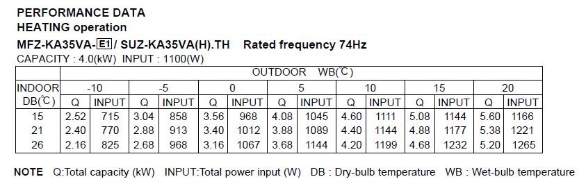

@ELSAK, GRETJE S KAKRŠNIMKOLIM KLASIČNIM GRELCEM (INFRA, TERMOAKUMULACIJSKA, OLJNI RADIATOR, IPD.) TE PRIDE VSAJ 2X DRAŽJE OD INVERTERSKE KLIME.
SAM IMAM KLIMO SUZ-MFZ KA35VA IN SE GREJEM Z NJO POL CENEJE KOT S KLASIČNIMI GRELCI ČETUDI JE ZUNAJ -10. V TRENUTNEM VREMENU PA CELO 4X CENEJE KOT S KAKŠNIM KALORIFERJEM.
SLEDEČI DIAGRAM PO ENOLETNEM TESTU KAR DRŽI Smile
ZATO TI PREDLAGAM MODEL KA25VAH OD MITSUBISHIJA, KI GREJE DO -20, ZA DNI POD -20 PA ŠELE PO POTREBI KLASIČNE POTRATNE GRELCE.
RES JE MALO DRAŽJA VARIANTA A BOŠ TO PRIHRANIL V ENEM LETU PRI ELEKTRIKI.
