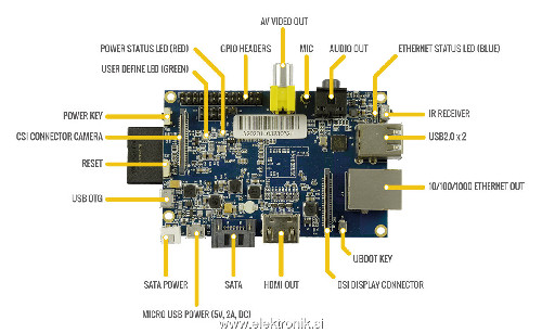

Zadevo sem namestil tudi na Banana pi (ARM Cortex-A7 dual-core 1GHz; 1GB DDR3 DRAM; Gigabit Ethernet; IR reciever; 2xUSB2.0; HDD/SSD SATA priklop...) Mr. Green
